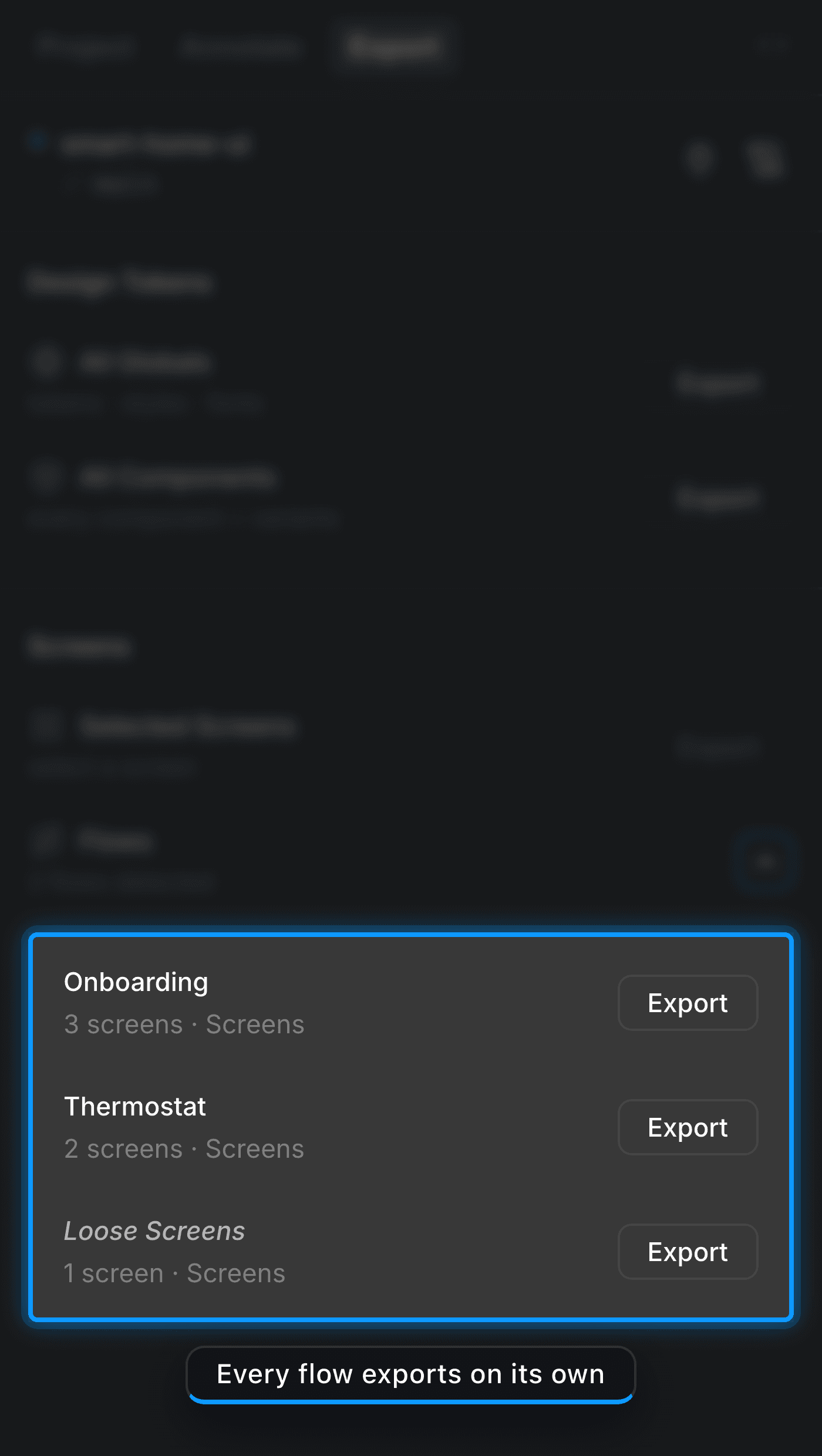

Exporting a flow
If you've wired your screens together with Figma's prototype connections, the plugin can follow those links and export a whole journey in one go: a login flow, an onboarding sequence, a settings path.
The Flows row works a little differently from the others. Instead of exporting on click, it opens a panel.
Open the panel. Click the Flows row and it expands inline. The first time you open it, the plugin traces your prototype links, and you'll see a brief "Tracing prototype flows…" while it maps out how your screens connect.
Pick a flow. Each flow it finds shows up as its own row, with a name and a count of the screens it contains. Any screens that aren't linked into a flow get gathered into a Loose Screens group so nothing is left behind.
Export it. Every flow row has its own Export button, click it and it exports those screens as well as their related tokens and components.
The Flows panel expanded with detected flows
The Flows panel lists every flow the plugin traced from your prototype links.
A flow is a set of screens connected by your prototype links, the same word Figma uses. If the plugin says "no flows detected," your screens probably aren't wired together yet; you can still send them with Selected Screens.
