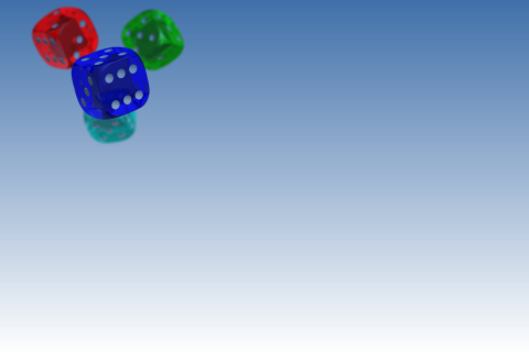

To see how lodepng works, we'll decode a PNG image file into an array and use this array as an image source in LVGL.
I used the image below and copied it into the project's root folder.
Example PNG image to decode with LVGL
For simplicity, I added all the code into main.c.

After compiling and running, I got this:
PNG image decoded in LVGL with lodepng

It resulted in the same image.
