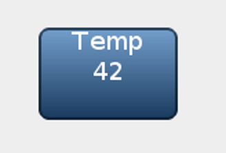

Let's continue the previous "button + temperature" example and display the stored temperature data on the button using a custom design function. For simplicity, the text is not aligned vertically.
Button displaying custom temperature text
Extended design function adds custom text to an LVGL button
/*Store the original button design function here*/
static lv_design_func_t old_btn_design;
bool new_btn_design(lv_obj_t * obj, const  lv_area_t * mask, lv_design_mode_t mode)
    if(mode == LV_DESIGN_COVER_CHK) {
       /*Use the original function for cover check*/
       return old_btn_design(obj, mask, mode);
    } else if(mode == LV_DESIGN_DRAW_MAIN) {
        /*Draw the original button first*/
        /*Draw a label*/
        temp_btn_ext_t * ext = lv_obj_get_ext_attr(obj);
        char buf[32];
        sprintf(buf, "Temp\n%d", ext->temp);
        lv_draw_label(&obj->coords, mask, &lv_style_btn_rel, lv_obj_get_opa_scale(obj), buf, LV_TXT_FLAG_CENTER, NULL);
    } else if(mode == LV_DESIGN_DRAW_POST) {
        /*Use the original function for post draw*/
    return true;
void test_btn(void)
    lv_obj_t * btn = lv_btn_create(lv_scr_act(), NULL);
    old_btn_design = lv_obj_get_design_func(btn);
    lv_obj_set_design_func(btn, new_btn_design);
c

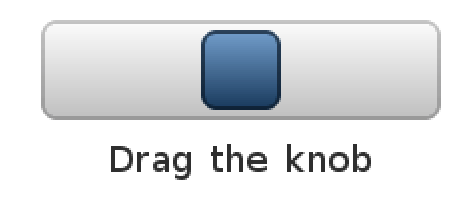

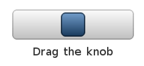

Position Limitation with a Custom Signal Function#
I'll show you an example of how to create a signal function which:
  • Doesn't let a button be dragged out of its parent
  • Enables only horizontal dragging
  • Animates the button to the middle on release
Without the new signal function it behaves like:
Button dragging without position limits
Position limit still not applied
But with the new signal function:
Button with constrained horizontal dragging and snap-back animation
Limit the position with signal function and add animation

void test_knob(void)
    /*Create a parent (gray rectangle)*/
    lv_obj_t * parent = lv_obj_create(lv_scr_act(), NULL);
    lv_obj_set_size(parent, 200, 50);
    lv_obj_set_style(parent, &lv_style_pretty);
    /*Create a square rectangle button*/
    lv_obj_t * btn = lv_btn_create(parent, NULL);
    old_btn_signal = lv_obj_get_signal_func(btn);       /*Save to old signal function*/
    lv_obj_set_signal_func(btn, new_btn_signal);        /*Set a new signal function*/
    lv_btn_set_action(btn, LV_BTN_ACTION_CLICK, btn_click); /*Set an action*/
    lv_obj_set_drag(btn, true);                         /*Enable dragging*/
    lv_obj_set_size(btn, 40, 40);                       /*Set the size*/
    lv_obj_align(btn, parent, LV_ALIGN_CENTER, 0, 0);   /*Align to the center of the parent*/
    lv_obj_set_protect(btn, LV_PROTECT_PRESS_LOST);     /*To prevent press lost on fast drags*/
    /*Create an info label for the demo*/
    info_label = lv_label_create(lv_scr_act(), NULL);
    lv_label_set_text(info_label, "Drag the knob");
    lv_obj_align(info_label, parent, LV_ALIGN_OUT_BOTTOM_MID, 0, 10);
