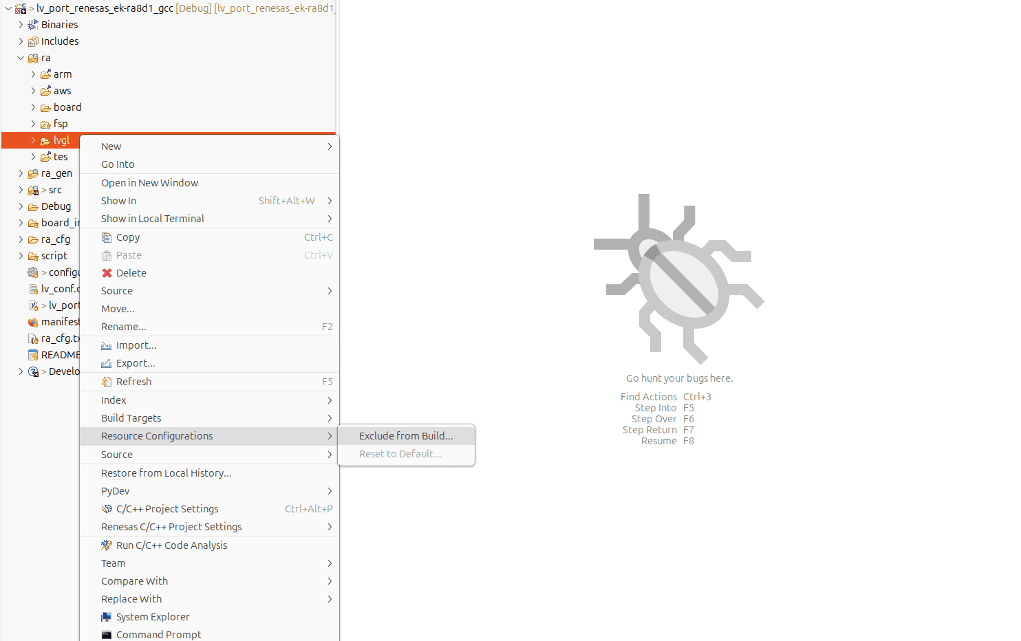

The first step is to exclude the FSP-provided LVGL sources from the build.
In e² studio:
  1. Right-click the ra/lvgl folder
  2. Select Resource Configurations → Exclude from Build
  3. Apply this to both Debug and Release configurations

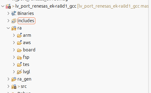

Exclude from Build dialog in e² studio
Excluded lvgl folder in the project explorer
After excluding from the build, the icon beside the lvgl folder should show the fact.
After doing this, rebuilding the project should result in unresolved LVGL symbols. This confirms that the original LVGL sources are no longer part of the build.
