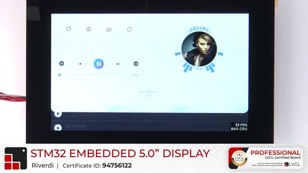

Riverdi STM32 Embedded 5.0 Display LVGL Demo

As you can see from the video it's clear that you won't have any issues with performance.
Frame Rate (FPS)#
We have measured a stable 33 FPS with 90-96% CPU load. While the frame rate is very good, the CPU use is a bit on the high side (it should be noted that the current software example does not utilize the GPU built into the STM32U599). Nevertheless, the animations were fluid, without any noticeable hiccups.
