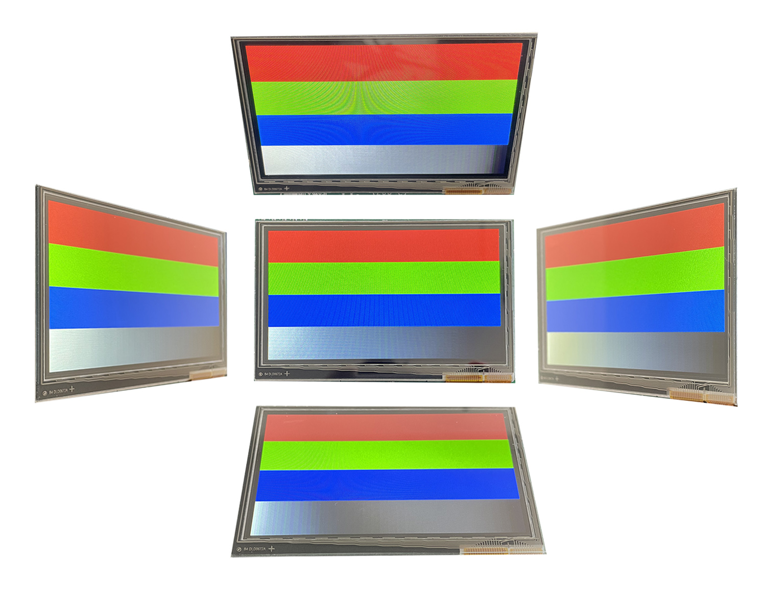

Display#
The display is built with TN technology, so viewing angles and color correctness are only average.
Viewing angles of the LPCXpresso54628 board's display
The DPI is 128 px/inch, which is quite good. The individual pixels are not visible from an average viewing distance.
