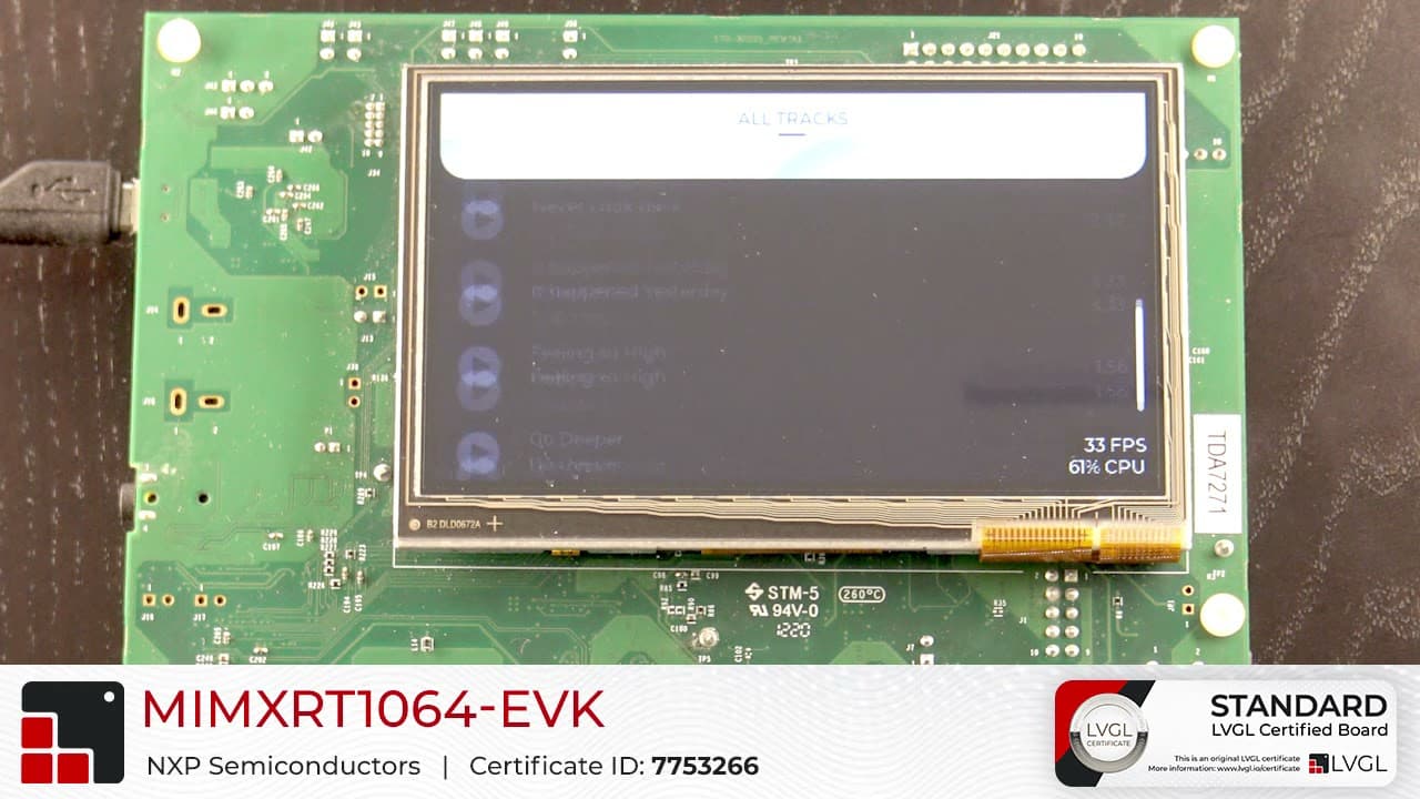

i.MX RT1064 EVK LVGL Demo
i.MX RT1064 EVK earned Standard LVGL board certification which means the users can be sure that it's easy to use that board with LVGL and they can expect decent performance and quality.
Standard LVGL certificate for i.MX RT1064-EVK

The MCU's 600 MHz clock speed and its ARM Cortex-M7 architecture are abundantly enough for the 480x272 display to create state-of-the-art UIs with image transformations, animations, opacity, and a lot of assets. i.MX RT1064 has PXP GPU that has built-in LVGL support. It can be simply enabled in lv_conf.h.
The MCU is equipped with an LCD controller to drive the display directly. Multiple frame buffers can be added to the board's external RAM and you can even add two to the MCU's internal RAM. From the frame buffer(s) the MCU automatically sends the current frame to the display.
The LCD controller supports maximum 1366x768 resolution which is about 8 times larger than the board's 480x272 display. The relation is not fully linear but if the UI has - for example - 50 FPS with 25% CPU usage on 480x272, it will have approximately 25 FPS with 100% CPU usage on 1366x768.
The board reached 33 FPS (the set limit) on the LVGL's certification benchmark. In the video you can see, that even the most complex transformations or scrolling the whole screen with all the animations were perfectly smooth. The benchmark used the display driver from the MCUXpresso's SDK as it is. The driver uses 2 frame buffers located in the external RAM.
It's not the fastest solution because accessing the external RAM takes more time than accessing the internal RAM. Using a smaller draw buffer in internal RAM (where LVGL renders) and copying it to an external RAM framebuffer once is much faster.

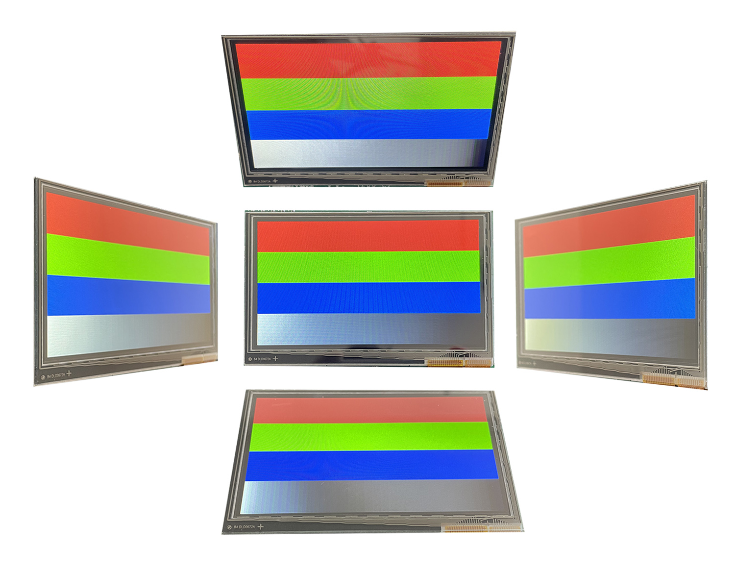

The display is built with TN technology so its viewing angle and color correctness are only average.
Viewing angles of the i.MX RT1064-EVK board's display
