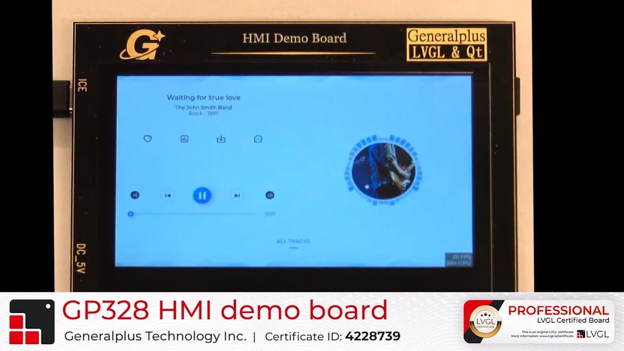

As you can see from the video the animations and scrolling run smoothly. There were no performance bottlenecks observed.
Frame rate (FPS)#
Using the 8.3.4 release of LVGL we have measured an average of 37 FPS with the Music Demo application. The animated arcs on the Widget Demo application run at a whopping 62 FPS with a CPU load of 38-44%. This performance is more than adequate for smooth UI experience in HMI applications.
Generalplus uses their own proprietary buffering scheme, therefore we did not test the board with various buffer configurations.

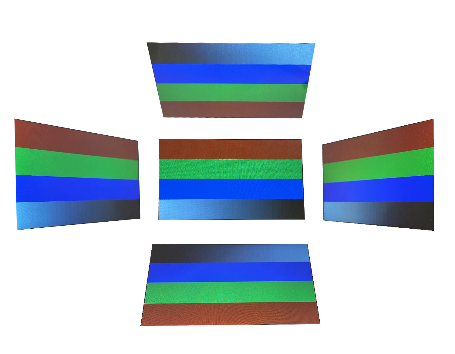

Display#
The board comes with an IPS display therefore it has good viewing angles, although the brightness is somewhat reduced when viewed from the sides. The brightness on the demo board was a little low despite of the claimed 500 nits, but this can be adjusted by replacing some resistors. The resolution of 800x480 pixels is very high for the size of the display (4.3"), which results in beautiful, razor sharp text and images.
Viewing angles of the Generalplus GP328 HMI demo board 4.3 inch display
Viewing angles of the 4.3 inch IPS display
