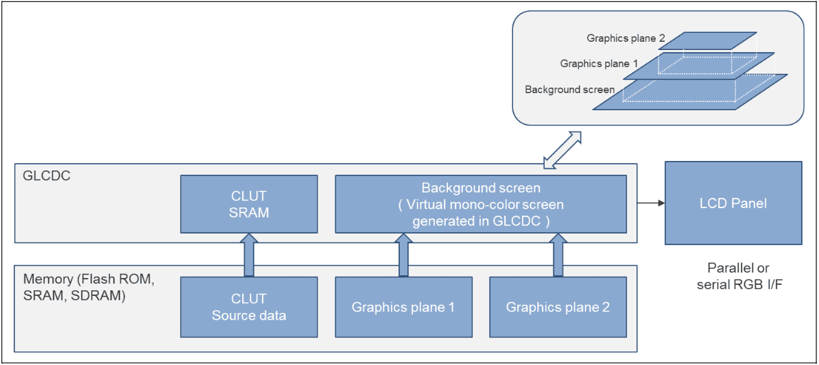

GLCDC is a multi-stage graphics output peripheral used in Renesas MCUs. It is designed to automatically generate timing and data signals for different LCD panels.
- Supports LCD panels with RGB interface (up to 24 bits) and sync signals (HSYNC, VSYNC and Data Enable optional)
- Supports various color formats for input graphics planes (RGB888, ARGB8888, RGB565, ARGB1555, ARGB4444, CLUT8, CLUT4, CLUT1)
- Supports the Color Look-Up Table (CLUT) usage for input graphics planes (ARGB8888) with 512 words (32 bits/word)
- Supports various color formats for output (RGB888, RGB666, RGB565, Serial RGB888)
- Can input two graphics planes on top of the background plane and blend them on the screen
- Generates a dot clock to the panel. The clock source is selectable from internal or external (LCD_EXTCLK)
- Supports brightness adjustment, contrast adjustment, and gamma correction
- Supports GLCDC interrupts to handle frame-buffer switching or underflow detection
