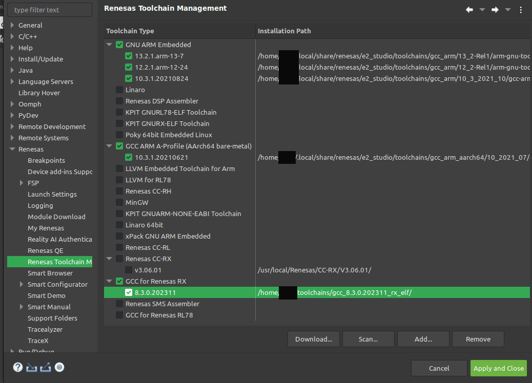

Install the RXv3 toolchain: RX72 requires an external compiler for the RXv3 core. A free and open-source version is available here after registration.
The compiler must be activated in e² studio:
  • Go to Help -> Add Renesas Toolchains
  • Press the Add... button
  • Select the installation folder of the toolchain
Adding the RXv3 toolchain in e² studio

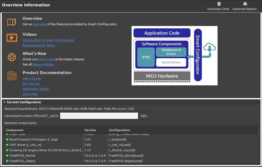

Generate the code: Double-click on RX72N_EnVision_LVGL.scfg to activate the Configuration Window.
Renesas' Smart Configurator (SMC) includes BSP and HAL layer support extended with multiple RTOS variants and other middleware stacks. The components will be available via code generation, including the entry point of the application.
Press Generate Code in the top right corner.
Code generation with SMC
