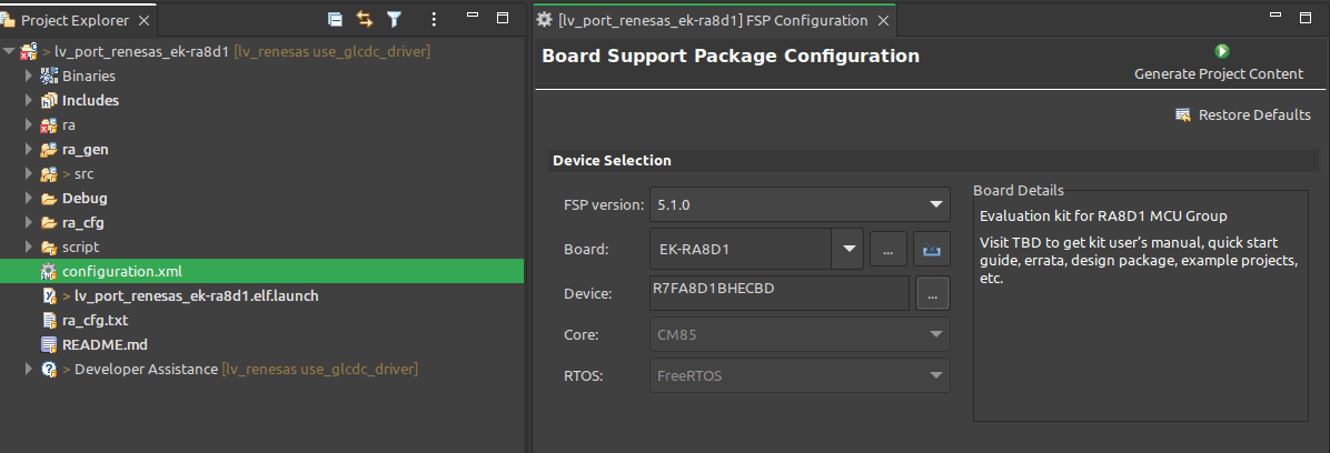

Generate the project content: Double-click on configuration.xml. This will activate the Configuration Window.
Renesas' Flexible Software Package (FSP) includes BSP and HAL layer support extended with multiple RTOS variants and other middleware stacks. The components will be available via code generation, including the entry point in main.c.
Press Generate Project Content in the top right corner.
Code generation with FSP

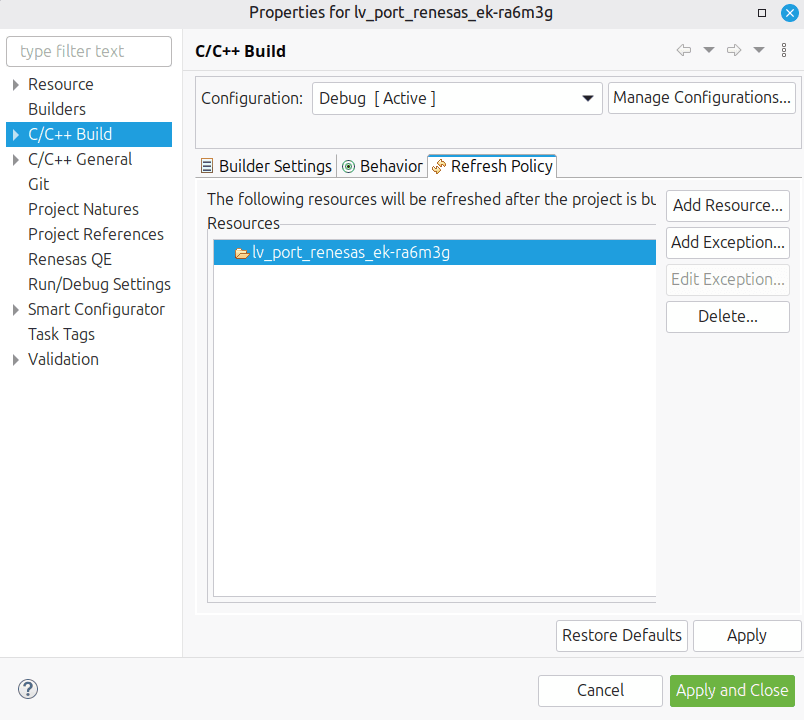

Missing Smart bundle
When you start debugging you might get an error saying that a Smart bundle was not found. To fix it, in the project properties go to C/C++ Build / Refresh Policy. You should see a different project name there than yours. Just delete it and add your project.
Fixing the missing Smart bundle error in the Refresh Policy settings
