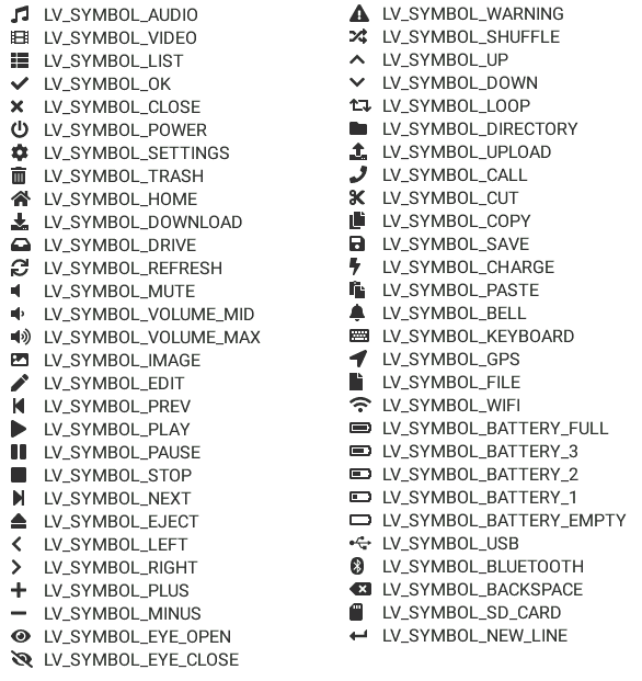

LVGL supports some predefined "symbols". A symbol is a specific Unicode character in a font with an icon-like image. The symbols have names like LV_SYMBOL_OK, LV_SYMBOL_HOME, etc. See the full list of predefined symbols below:
Symbols
The symbols in the built-in fonts are created from the FontAwesome font.
Using these symbols is very simple:
lv_label_set_text(label, LV_SYMBOL_OK); /*Just a symbol*/
lv_label_set_text(label, LV_SYMBOL_OK "Apply"); /*Concatenate with a string*/
