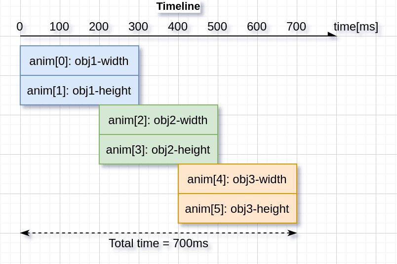

Timelines
You can create a series of related animations that are linked together using an Animation Timeline. A Timeline is a collection of multiple Animations which makes it easy to create complex composite Animations.
Anim Timeline
To create and use an Animation Timeline:
own copy of the contents of the Animation template, so if you do not need it later, its contents do not need to be preserved after this call.
It supports forward and reverse play of the entire Animation group, using lv_anim_timeline_set_reverse(timeline, reverse). Note that if you want to play in reverse from the end of the Timeline, you need to call
lv_anim_timeline_set_progress(timeline, LV_ANIM_TIMELINE_PROGRESS_MAX)
after adding all Animations and before telling it to start playing. lv_anim_timeline_restart(timeline) does that for you.
Call lv_anim_timeline_pause(timeline) to pause the Animation Timeline. The position it reached is kept, so lv_anim_timeline_start(timeline) continues from there, and lv_anim_timeline_restart(timeline) plays it again from the beginning (or end if reversed).
Call lv_anim_timeline_set_progress(timeline, progress) function to set the state of the Animation Timeline according to the progress value. progress is a value between 0 and 65535 (LV_ANIM_TIMELINE_PROGRESS_MAX) to indicate the proportion of the Timeline that has "played". Example: a progress value of LV_ANIM_TIMELINE_PROGRESS_MAX / 2 would set the Timeline play to its half-way point.
Call lv_anim_timeline_get_playtime(timeline) function to get the total duration (in milliseconds) of the entire Animation Timeline.
Call lv_anim_timeline_get_reverse(timeline) function to get whether the Animation Timeline is also played in reverse after its forward play completes.
Call lv_anim_timeline_delete(timeline) function to delete the Animation Timeline.
If you need to delete a Widget during Animation, be sure to delete the Animation Timeline before deleting the Widget. Otherwise, the program may crash or behave abnormally.
To prevent undefined behavior, the Animations subsystem does not allow more than one Animation to execute concurrently when they modify the same target object with the same animator callback.
If you have set up an Animation Timeline from 2 or more Animation Templates with these characteristics, be aware that when the Animation is started for any of them, the Animation subsystem looks for such cases and considers it a conflict when:
  • more than one are running concurrently, or
  • more than one have their "early apply" behavior turned on (which it is by default).
When this is detected, all such Animations are deleted except for the one most recently added.
To avoid this, if you want to use more than one Animation Template that updates the same object using the same animator callback:
  • ensure that all but the first one to execute in the Timeline have their "early apply" default behavior turned off before starting the Timeline, and
  • ensure that they do not execute concurrently.
