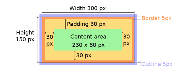

lv_obj_set_size(widget2, 200, 100);Boxing Model
LVGL follows the CSS border-box model:
https://developer.mozilla.org/en-US/docs/Web/CSS/Reference/Properties/box-sizing
A widget's "box" includes:
| Field | Description |
bounding box | Full width/height of the widget. |
border width | The width of the border. |
padding | Space between the border and the content/children. |
margin | Space outside the widget (used only in some layouts). |
content | The content area (bounding box minus border and padding). |
The border is drawn inside the bounding box, and padding is applied inside the border. The outline (if any) is drawn outside the bounding box.
Use:
lv_obj_set_content_width(widget, 50);This sets the width of the content, and the actual widget width will include padding and border.

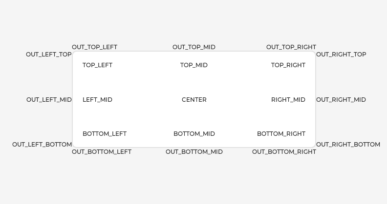

Align to the Parent
You can position a widget relative to any side or corner of the parent:
lv_obj_align(widget, LV_ALIGN_TOP_RIGHT, -10, 5);Or:
lv_obj_set_align(widget, LV_ALIGN_BOTTOM_MID);Available anchor points:
LV_ALIGN_TOP_LEFT -
LV_ALIGN_TOP_MID -
LV_ALIGN_TOP_RIGHT -
LV_ALIGN_BOTTOM_LEFT -
LV_ALIGN_BOTTOM_MID -
LV_ALIGN_BOTTOM_RIGHT -
LV_ALIGN_LEFT_MID -
LV_ALIGN_RIGHT_MID -
LV_ALIGN_CENTER
Use lv_obj_center(widget) as a shortcut to center a widget.
Align to Another Widget
Align to a different reference widget:
lv_obj_align_to(label, btn, LV_ALIGN_OUT_TOP_MID, 0, -10);This places label 10 px above btn.
