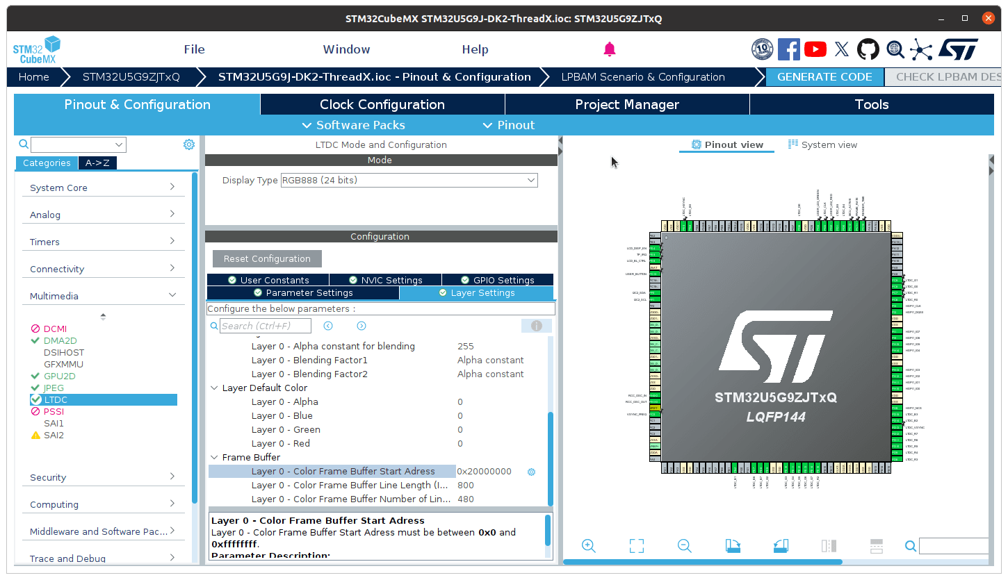

To clarify what my_ltdc_framebuffer_address exactly is, it's the value of pLayerCfg.FBStartAdress when the LTDC layer is configured using the STM32 HAL, which is written to the CFBAR register of the LTDC layer peripheral.
The LTDC framebuffer start address in STM32CubeMX
