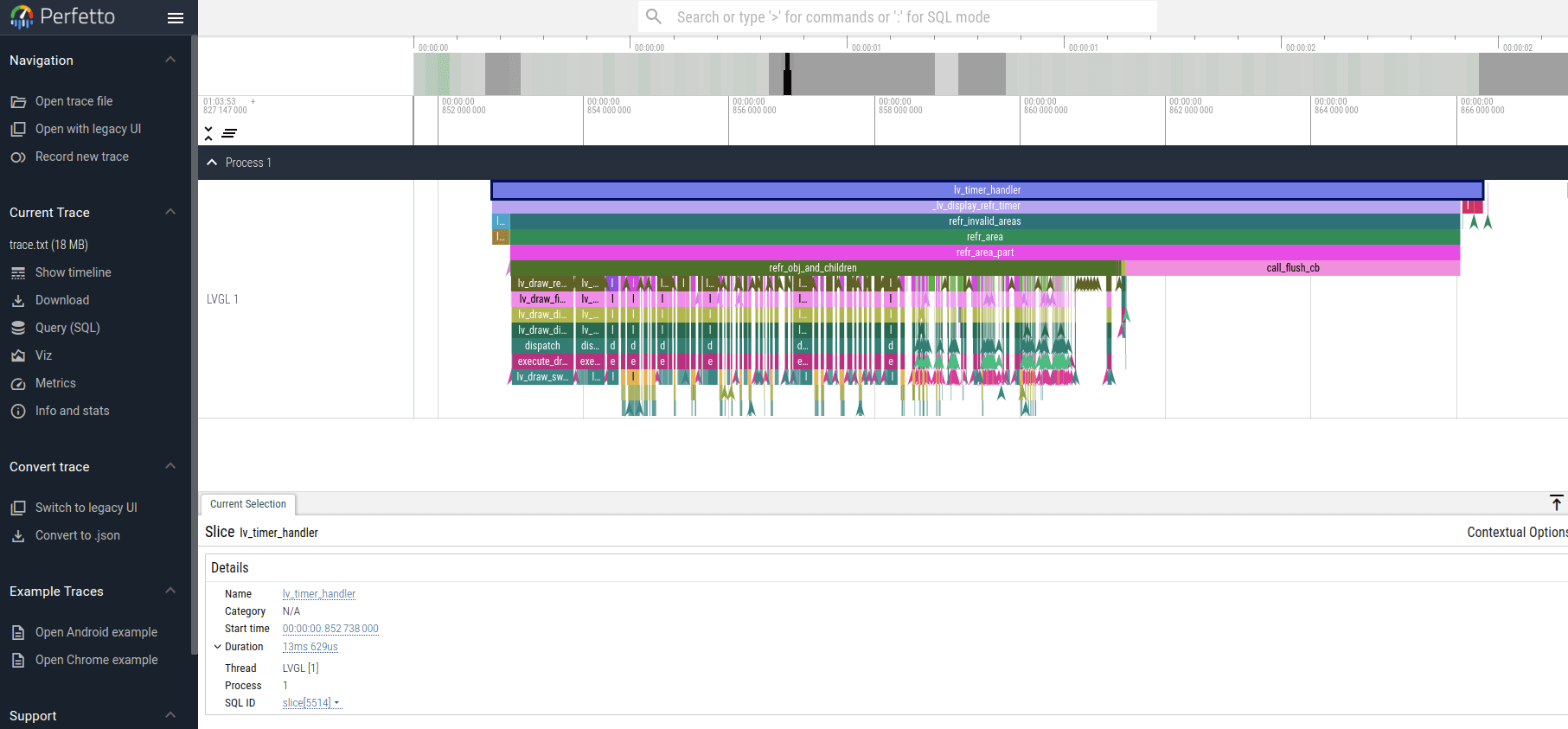

Import the processed trace.systracefile intoPerfetto and wait for it to be parsed.
Performance analysis
If the log parsing is successful, you will see a screen similar to the following:
Perfetto Ui
In the Perfetto UI, use the A or D keys to pan the timeline horizontally and the W or S keys to zoom in or out on the timeline. Use the mouse to move the focus and click on functions on the timeline to observe their execution time.
