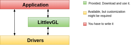

System overview
../_images/sys.png
Application Your application which creates the GUI and handles the specific tasks.
LVGL The graphics library itself. Your application can communicate with the library to create a GUI. It contains a HAL (Hardware Abstraction Layer) interface to register your display and input device drivers.
Driver Besides your specific drivers, it contains functions to drive your display, optionally to a GPU and to read the touchpad or buttons.
